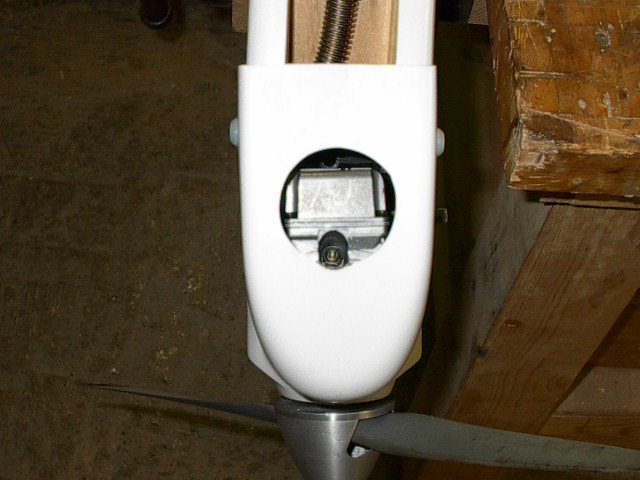

finished my DO today, the radio problem was due to a bad RX which also explains my TF-P51 unexplained demise. Thanks for the help on this group. I tried to upload a photo hope it took. I plan to fly in the morning and will report my thoughts.

Brad SD...
Good looking plane. Hope you enjoy it as much as I do mine.
My only comments would be that I think you need to cut the cowl for more air flow. It doesn't look like you have enough to me. You may get overheating problems the way it is.

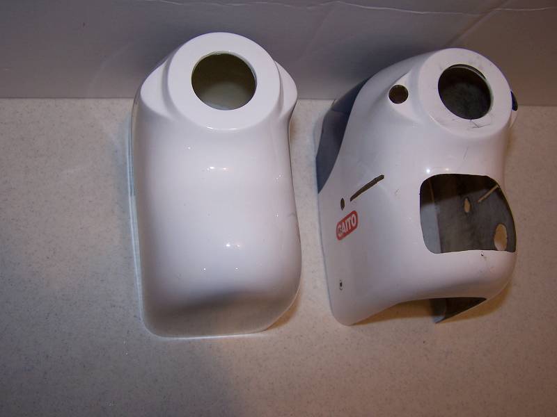

Brad, Barry is giving some good advice and I bet its from some hard earned experience. Gotta get all the air flow that you can. I look at it this way, cut the front as big as the cylinder and head and then get all you can from the back. Good luck, Joe
