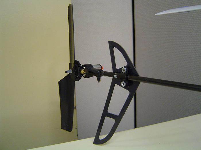

Almost forgot, what is the accepted repair for the tail skid?

Well, I just fixed my tail boom after attacking the couch. First taped, then wrapped with thread beyond the tape, then a few drops of CA, maybe 5 to soak all the thread. Straightening the main shaft again now. LOL What is it with me and this mainshaft ? Got it straight again, but im afraid if I don't quit crashing, Im gunna break some kind of record for a guy who can easily hover a whole pack. LOL Took my thunb off the left stick to scratch my nose, and oops !!! Bad time for the voltage to say "go that way now". Soon as I touched my nose, the tail went between 45 and 90 degree's off. Maybe that tail motor is getting weird finally. It's been doing that lately, I just been living with it. Remember, land before scratching anything. LOL In about 20 minutes, she'll be good as new, only and less nose heavy than it was. Now it's almost perfect !!! Good thing I crashed !!! LOL

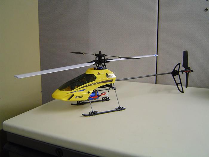

ORIGINAL: nyflyer56
The stock tail skid is garbage, I replaced mine with a fin from heli-direct.com. I attached it to the tail boom with a 3/16 landing gear mount. Here are links to everything I used:
Here's the tail fin:
http://www.helidirect.com/product_in...roducts_id=751
It's for a HoneyBee Cool or King.
I fastened it on with a Du-bro 3/16 landing gear strap, part number 811. Which fits perfectly around the tail boom. I used a little masking tape inside the landing gear strap to firm up the fit. You can see them here:
http://www2.towerhobbies.com/cgi-bin...&P=WR&I=LXVJ28
I used Du-bro 2-56 Steel Hex nuts part number 560 to fasten it to the boom. Those are the best way I found to mount it. Both are easily available at your local hobby store.
I snapped off two tail supports within about a week of each other. I haven't had a single problem with the tail since putting on my fin and it looks good on the blade. Heres a couple pics:
