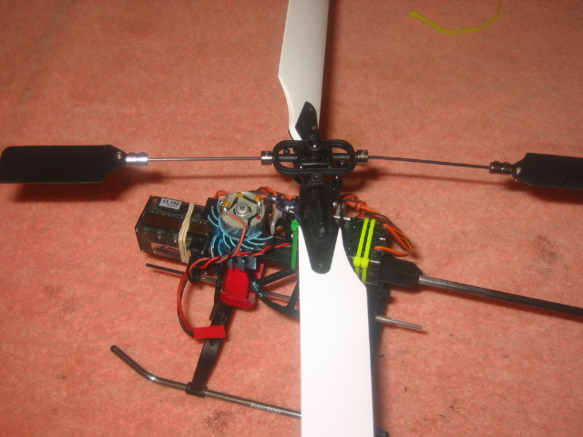

I reversed the aileron...
now when throttle up, right rear servo goes up and the rest go down....
switched the aileron back to normal

OK...This is going to sound stupid but two of your servos are plugged into the wrong channel. Try switching the alieron and pitch servo channels with each other. I had the same problem setting up the DX6. Tell me what happens.
...I'm waiting here....

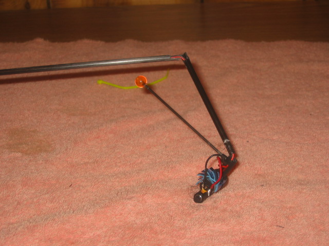

Choppersrule Here:
Another Disaster:
Got my back-up CP all put together, flew great for 2 battery packs, 3 pack had a hard landing, nothing out of the ordinary hard landing.
Broken tail boom, two places, bent fly bar... I'm so mad, I could spit... I just spent an hour getting it all together and BLAM.
The CX2, like your's Lookyj, I only get 3 to 4 minutes of flight on it... That sucker, trust me, is going in the garbage, I don't want to invest anymore money in it.... Done it before....GARBAGE
I'm going to do the build on my project, brushless, gyro, dd tail. That's it. Any more disasters, I'm gonna "let it go" for awhile. Getting reallll frustrated.
Don't let my catastrophies get YOU down, just having a hard go right now....

Hey Wick, I found I need to keep the gain real low to keep the tail from twitching. I wondered about interference at first too but try turning your gain down and the tail should settle in. The manual says you can adjust the gain without having to reset the 4 in 1 but as a habit I always power down before changing any of the settings.

Disregard, Crash already pointed this out...
Lookyj,
You still have your elev and pitch servos reversed. The back servo that is on the other side of the boom from your tail rotor blade should be plugged into the Aileron Channel on the receiver. The servo on the same side as the tail rotor blade is the pitch. Swapping these will fix your problems.
Lookyj,

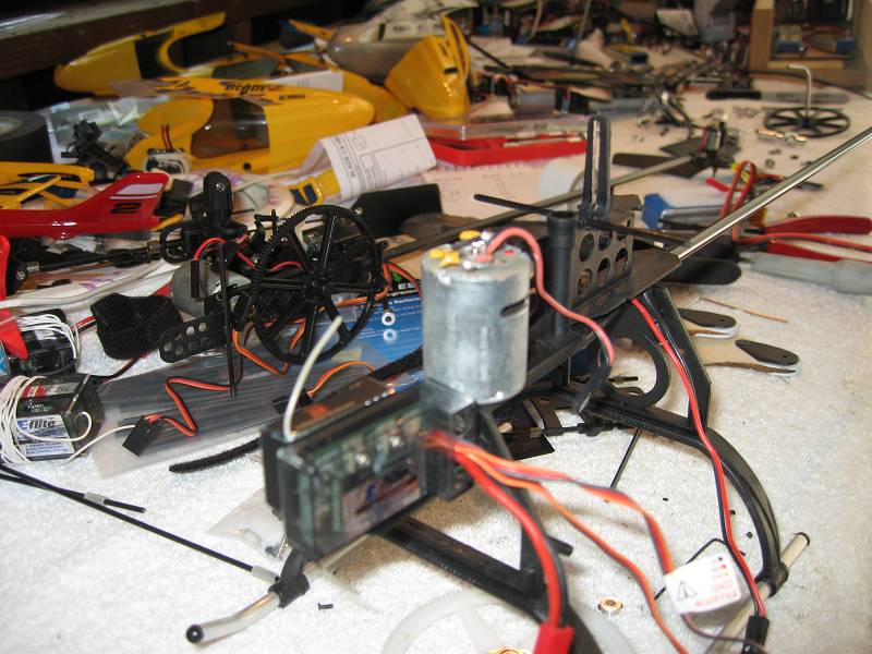

dave,
I too am doing a ground up rebuild on a new bird....
here's the first pics...
also, if you don't want your CX2... I'll gladly purchase and give a good home! The coaxial helis keep me sane during these build projects!
wick,
the main shaft wasn't really that bad, but it was beyond repair.... so I gave it a nice 90* bend for pic!
however, I was unable to remove the mH main shaft from mH CNC center hub! Now there's a half inch piece of shaft that broke off in the hub.... DO'H
wick,
