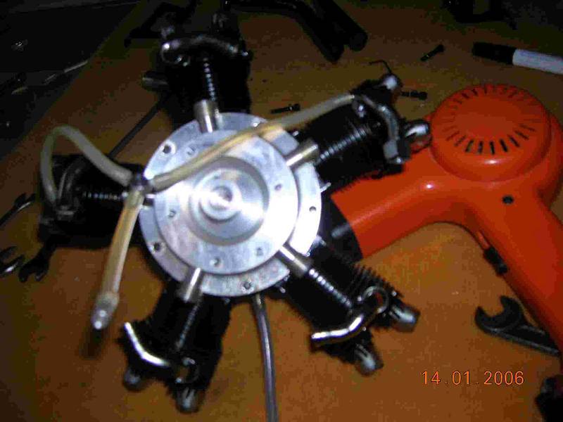

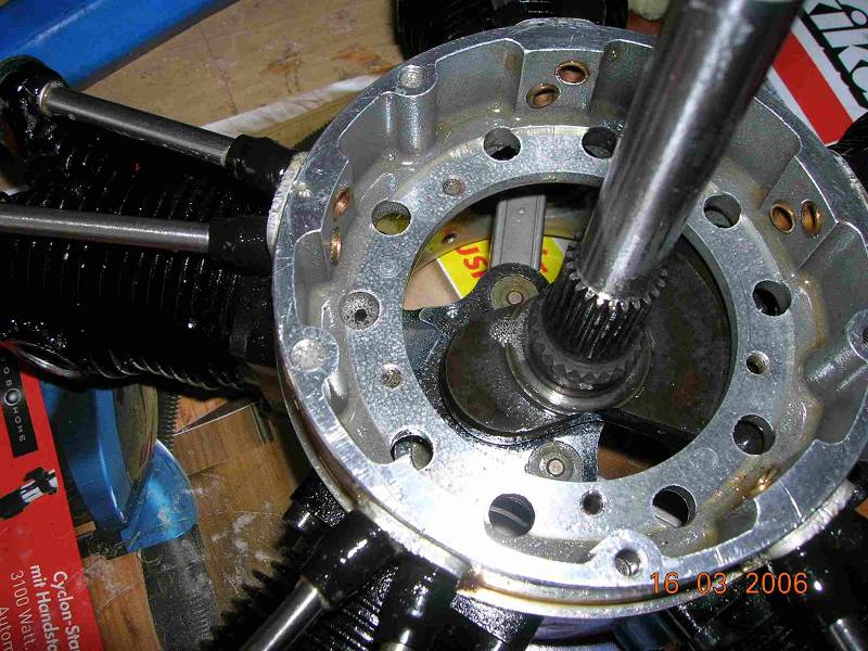

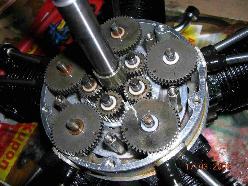

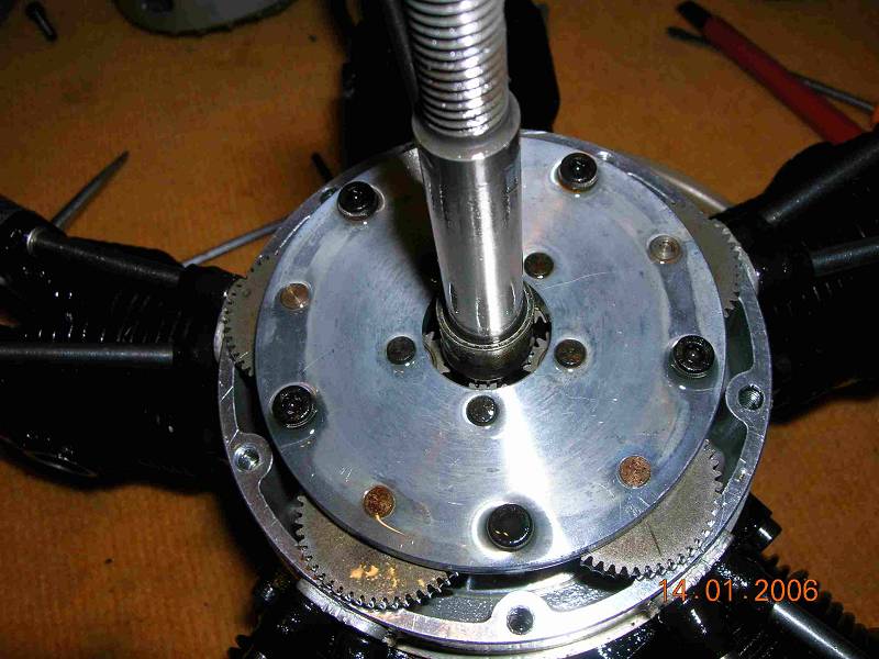

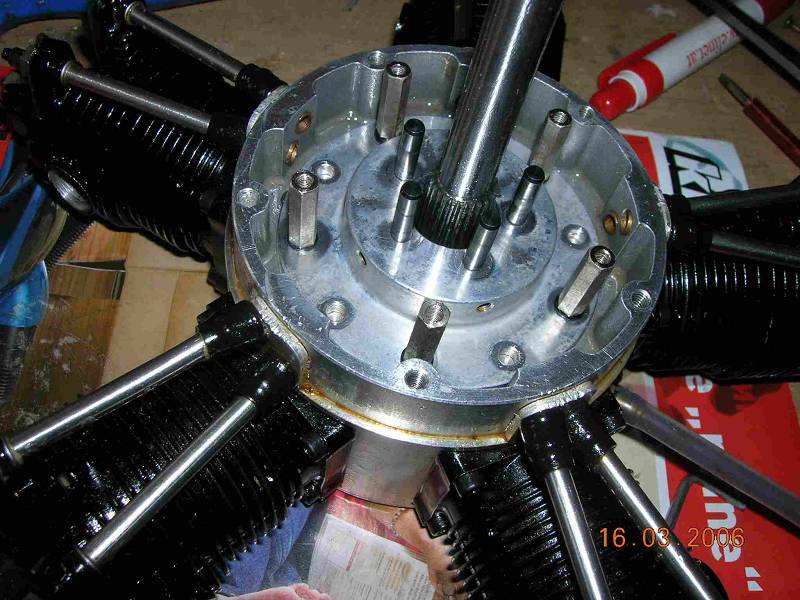

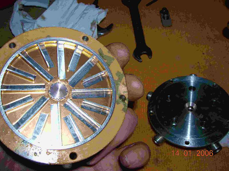

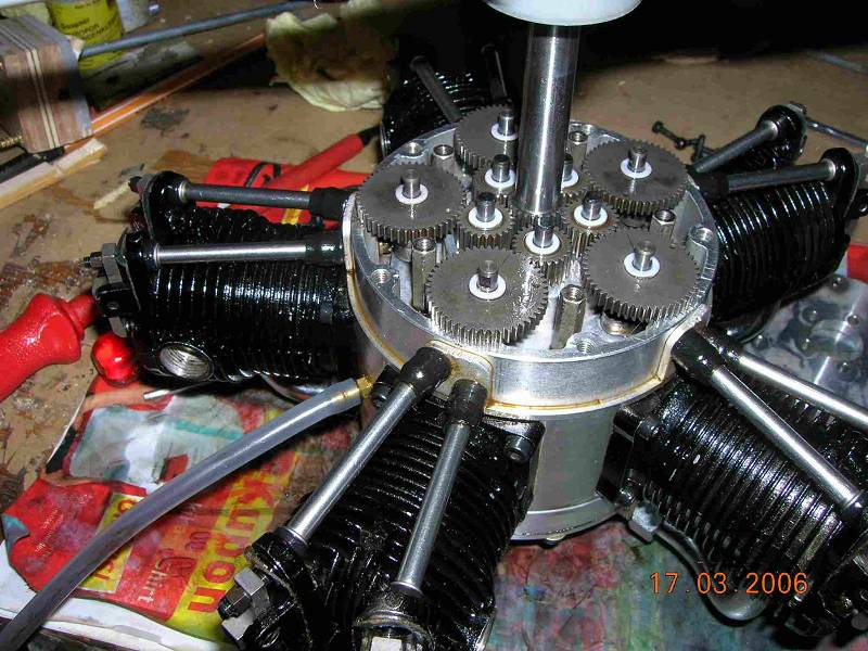

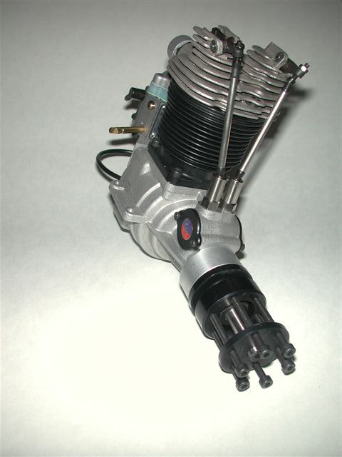

into FW 190 i place now the famous MOKI VT50-4 (50 cc 4stroke gas engine- the cylinder is from the 250cc radial ) ) www.airworld.de
than i had to make service, cause the ball-bearings were rusted, so i had to dismount the whole engine to change the bearings,
and i putted in nirosta-bearings;
fotos of *intim* Saito beyond, is already running again

Wow! First time I have seen the inner workings of the Saito radial. Thank you Flugmax!
Look at the gears! What a job to time them all?

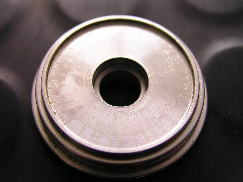

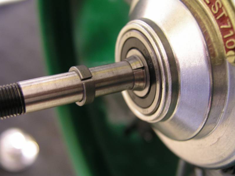

Hello Sandman, here the pictures of the spanners and the hub. The hole in the hub is 13mm diameter and 3.7mm deep, the hub is 8.6mm thick. I bat the dimensions are quite the same as on the ST 770 prop hub!

Gnome: Thanks bigtime...
I was s little supriced that the rear hole was cylindrical, on my ST-770 here are a conical split ring both in the rear and front of the hub, and the holes are allso conical..
If you haven`t all ready assembled the hub-prop assy, could you verify if the propshaft is identical as my 770.
Total length :67mm, 18mm treaded and 10mm diameter.
I think that I will make my own hub, it would properly be more easy that ordering on from Seidel :-)

Hello Sandman, here the measurements:
shaft length (from ball bearing to the end) : 57mm
thread length : 17mm
shaft diameter : 10mm
thread : M10 x 1
I think that You can get the two spanners, one with inner tapper and one with outer tapper, from Mr. Seidel, so that You don't have to make a tappered hole with the correct angle inside the hub, a cylindrical hole for the spanner with the inner tapper can be made much easyer. As the ST710 shaft is 10mm shorter, You probably can make the hub thicker.
