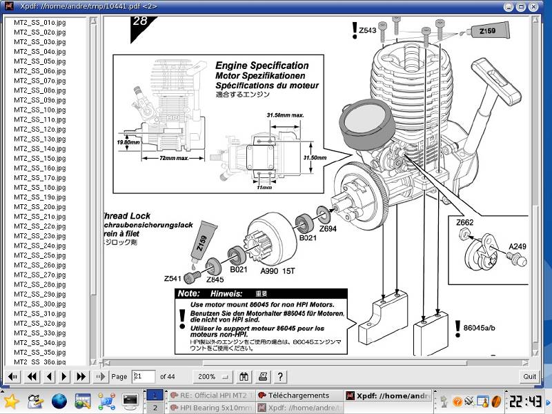

Here a pic of what your going to need, BTW I ran the CB with the needle bearing on my son's MT2 for a long time before replacing it with the Savage set up. Hope this will help. The Z845 cone can be replace by the Z694 washer.

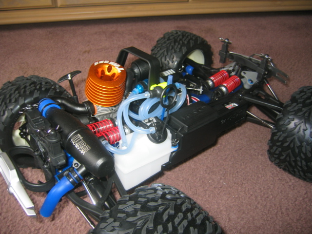

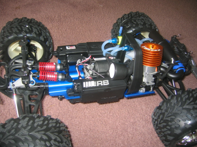

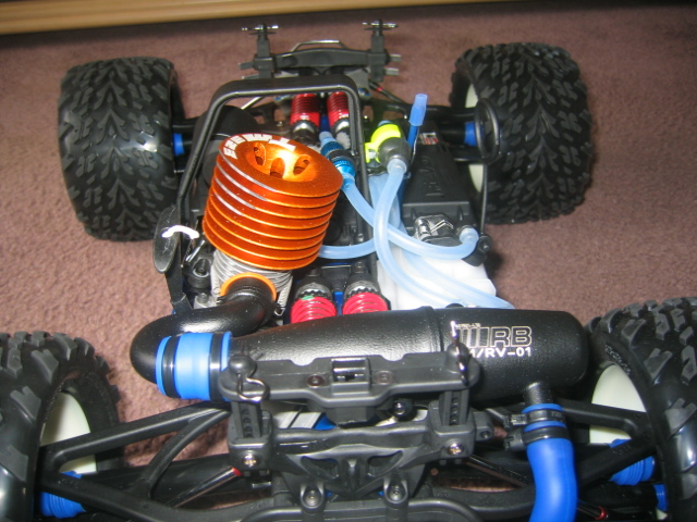

No right out of the box I've replace the engine with the RB Concept TM323 REVO kit and got rid of the electric ignition system (now i got the pull start) , I read more bad things than good things about all Traxxas engines so thats why i replace it right away (personal choice). Only went thought one tank using the heat cycle method for break in and it when flawlessly had to preheat to engine the pitch is so tight. The Revo engineering is amazing hope its run as good as it looks and i will be happy with it.

To put the Savage clutch bell use none flanged bearings size 5x10x4 and are these beveled washer you are talking about?
http://www2.towerhobbies.com/cgi-bin/WTI0001P?&I=LXLZY6
Has the same part number as in the MT2 .18 SS manual if I am not mistaken.
