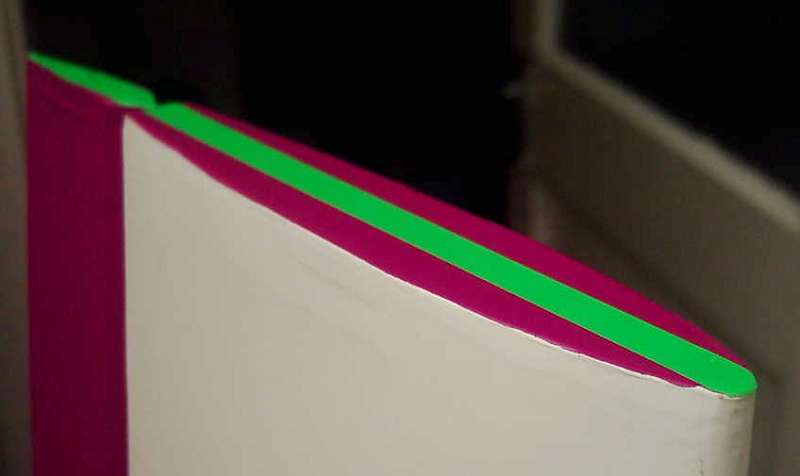

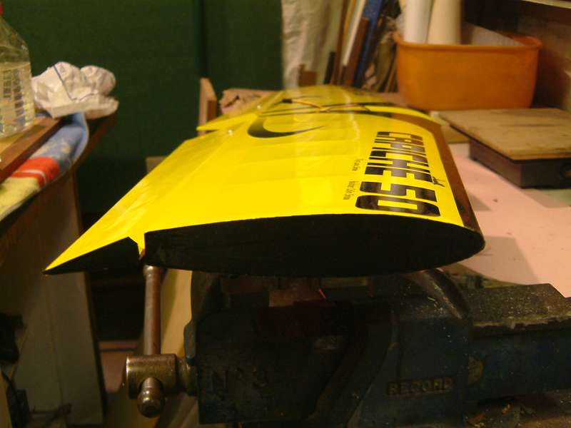

sprink: you've really confused me now...
you wont get an edge on the wing tip.. ok, but now you have a line where the tips glued on AND you've still got a tip to cover... looks like your going to over lap onto the wing fron the tip??? open for ugly lines...
hang on.. i'll take pics...
ok, two pics...
the capiche tip is the wing film curved down, then the tip trim put on and sliced clean.. the Shrike was the other way around, i did the tips first, then sliced the wing covering to the edge. both are prymoled on the join.
i remember Malc saying something about a different shape to the FF wing from normal paralell.. just wondering how tapered tips would effect it. was there a basic shape? something i can work from. i know enough to make a FF wing that would work, but it needs to be a Capiche wing, done in Capiche style
ok, two pics...

Hmm, now I'm confused.
Current plan (too late to change now, too far down the wing covering road) is to cover the wing, excluding the wing tips.
Then decide what colour to do the wing tips (leaning towards red at the moment), and cover them.
Then glue the wing tips on to the wing.
If I do go for red, then I will get a join line, but it will be fine. If I go for another colour, the join line wont be so easy to see as the colour will change at that point. I'll try to take photos tonight when the wing is done.
Looking at your photo, you have covered the wing in white, folding/stretching/shrinking the covering over the edge. Then covered the end with the purple, and trimmed around the edge to line up with the wing tip? Just think my method is a little bit neater.
Mind you, if the best we can argue about is how to cover the wing tips, says a lot for how good the plane is.

pretty much, except you don't need to strech and srink, you end up with little 3mm deep tabs you just fold down. you do need a sharp knife to get a clean edge.
'm not so worryied about a line in your case, just at best a v shape where they meet ( dure to the curve set whe ironing ) at worse total missalignment. ith the tips in place you sand the lot down. if you can't do tips neat, you've got two edge on unneat faces to glue... i just see it as over hard and bad news, too easy to get wrong.

Thats a pretty Scabby looking tip Philly
Try this one As you said cover with a minimum overlap then just cover tip flat.
Very easy
A funfly wing with its massive compound curves a diffo story
Very easy

that tip is fine mate, and in fact, done as you just said. just in less words.
seeing as the colour difference is a bit obvisious i thought it looks ok, even that close!

whats wrong with you guys? sure the Capiche tip has a tiny bit of purple missing near the LE where it tore not cut, but the pic is about 1.5 times bigger than real life! once further than 3" away you can't see that! come on then, lets see your over laps amd tips close up
as for the rough bit on the Shrike... thats where it lands and hits all sort of moo poo and electric fence stuff..
compaired to the rest of the film which is lifting on the tail etc the tips are blimmin perfect :P
