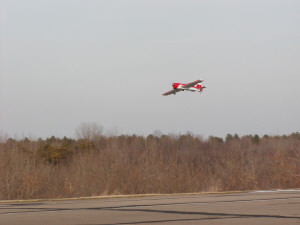

Rob,
I got to maiden it today!!!
SuperStick was right on the money with his flight report!! The aerobatic capabilities COMPLETELY surprised me! With the relatively small control surfaces, I thought the plane would be kind of calm.....not so! This thing snap rolled like a blur, and I was able to get it halfway through a knife-edge loop. Spins are VERY tight (I didn't try any flat spins yet). It is definitely sensitive on the sticks......and it WILL snap (quickly) with too much elevator....be easy on the stick. I didn't notice sluggishness with the ailerons, but I did have the throws set higher then recommended. The GMS .76 pulled it very well....I mostly flew at 1/2 throttle.
I think I'll be changing mine too........I flew the plane for only about 6 minutes.....than ran the plane on the ground for only about 4 more, and the tank was empty.....I think I'll install a flew tank also.
I did build mine with the fuel tube......and my filler line comes out at the bottom of my cowl.....since I don't like some of the problems that can't come along with remote fuelers, I use the DuBro "Fill-It" Fuel system. It's basically a set of fuel line plugs for the 3rd line......astro, the line must be plugged or else the fuel would come out....and you wouldn't have fuel pressure either. I'm looking forward to flying it again!

sorry to hear that wolf [:@] Glad it wasn't as bad as it could have been.....and I'm also glad that I'm using 2 servos on my elevator!
Mine is in the shop now too..........motor quit on take off at about 40 feet up, at a 45 degree angle........thought I could get it back, so I turned around, dove down to pick up speed, went to level off and had nothing.....turns out that I had a 10-15 mph tail wind, so my airspeed wasn't sufficient to fly.....I was below the stall speed when factoring the tailwind.....I should have kept it into the wind and let it float into the woods, but it's hard telling yourself that when you think you can get it back on the runway.
It hit the asphalt at about a 40 degree angle.....the muffler took the brunt of the impact, and broke right off......the spinner is scraped up, but can be buffed, the cowl is a little scratched, the firewall and landing gear area is busted up pretty good, but definitely fixable......the plane hit VERY hard....I thought it would be sticks, so I was pretty happy. Should have it back in action in a couple of weeks.
