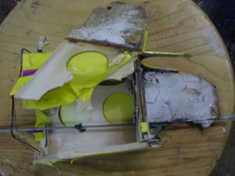

Just use the end of the other side as a template to make a new former. I replaced at least 3 formers in mine when i crashed. It took a little while but wasn't that hard to do. In all for the $99 plane it's not worth spending a ton of time on unless you like playing with glue, so for me and others it was worth it, if your not into it, then give the plane to someone in your club, I'm sure someone will want to fix it.

Fix her up hobie !!! Trace the other end, just do the front half and then replace the whole broken half,,, You'll be happy you did, you will learn a little and the reward for yourself is priceless.

Thanks for all the replies guys . Sachin I am 2 1/2 hrs from Chicago so with the cost of gas it wouldn't be worth driving 500 miles to get a wing for a plane I paid $20 for but thanks anyway . Schu what did you make the formers out of and how did you cut them out ?
I don't have good saw just an old hand held electric jigsaw . Waldopepperaxel so do you rcomend cutting away the broken part back to where I can match a flat surface ? Because of the big holes they put in the formers it makes it hard to just replace the broken part . I set up the Twist PNP yesterday finally ran 2 tanks through the Evo engine . All I have to do is tune the engine better and get the CG right . The fly in isn't till mid August and I still would like to save the PNP till just a couple weeks before so I have a nice shinny new plane to fly . I still might try and do the repair but I am lousy working with wood .

Just trace rib pattern from other wing tip and cut another rib half to glue behind it while putting the damaged pieces back in position and recover. You can use balsa as the tip rib is thick balsa. I would not worry too much about the lightening hole. You can cut it all with an x-acto knife.

A sharp hobby knife will cut through balsa like a hot knife through butter. You can free hand any shape you want. Just lightly sand the cut edge when you are done and this will take out any imperfections. Shouldn't take more than a couple of mitures to cut a new rib.

OK OK guys you have encouraged me and pressured me into giving it a try . I don't have much confidence in trying to do this and you may have to wait awhile to hear and see how it is going . First I will have to find some 1/4 inch balsa . I wish I had all the broken pieces it would make it easier . I thought I had all of the pieces everything but my pilot but standing in neck high weeds with my legs itching and bleeding I didn't spend much time taking inventory . It may take awhile to get started but I subscribe to this thread and I will let you know of my progress or lack of progress when I get started . Thanks Twisters for all the input I may have more questions later .

Hobie,
Hopefully this picture will help:
As you can see I cut a square hole that spans to the middle of the next former like the sheeting repair article suggests, which puts the broken former in the middle. I then cut out the leading edge balsa shown, and glued in a new piece I bought at the hobby shop. After that I made a new former by tracing the end then I glued it to the side of the the broken former. Now that I have a new former and new leading edge balsa, all that was left was to sheet it as described in the repair article then sand to shape.
Hopefully that helps. If it doesn't let me know and I'll walk you though it on the phone.

Did the wing tip today one of the worst things other than when I get to the covering which I have only done small patch jobs . It isn't pretty but but all I want to do is get it back in the air plus the covering should hide it all . Of course the cover job could look worse than the repair . Thanks for all the encouragement I now think I might be able to actually repair it
. I do have a long way to go though .
Here is my first before and after shots of the wing tip .

Hobie,, GREAT JOB,, If I were you I'd wrap some packing tape around that thing and send her up at Sunrise, she's ready for the sky.
