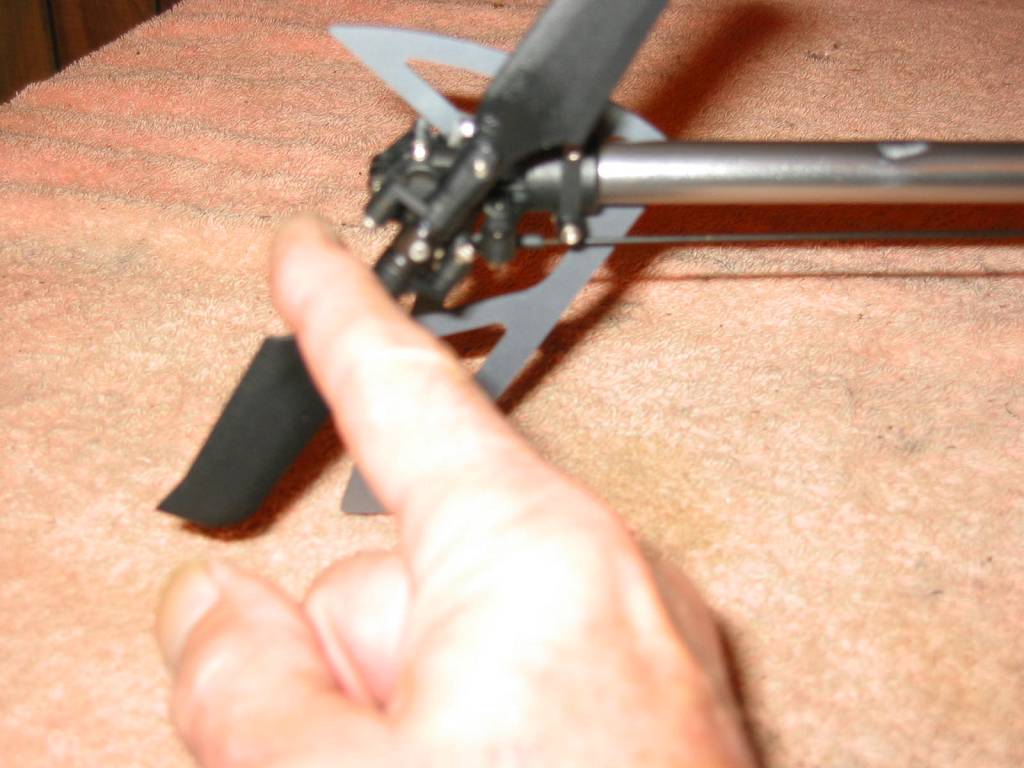

my tail is spinning out of controll again guys. Just got the new tail blades on and the tail is spinning in a counter clockwise direction. Is that right? I also have the trailing edge of the blades going down. When spooling up, if I give ti any rudder inputs she starts spinning crazy one way or the other. Please let me know what I'm doing wrong........again. Thanks, Joe

Belts tight, main blades spin Clockwise and tail blades are spinning counter clockwise. I did put my new carbon fiber tail boom on. Maybe the belt is twisted the wrong way in the tube. the only reason why I think it wouldn't be is because of how smooth it feel when spinning it by hand. I'll try flipping it around to see what happens. I bet thats what the problem is hahaha I'll post results.
Joined: Sep 2006
Posts: 2,277
From: Burlington,
NJ
Tried flipping the belt all different ways and that did nothing but make it worse. When back to "normal" spinning all the right way and smooth, the tail just goes nuts. In my Futaba 7C Tx, in "gyro" menu, as far as % I'm at 30% and it's set to "A" rather than "N". what's that all about?

If viewing the tail blades from the side, they were spinning counter clockwise which I guess for my set-up is wrong. I flipped the belt, had it going clockwise, toward the heli, and I flipped the blades around and now she soild again. I think it's about time I write this stuff down because Im just tired of going through this. I can never remember hahaha But thank you guys for the support.

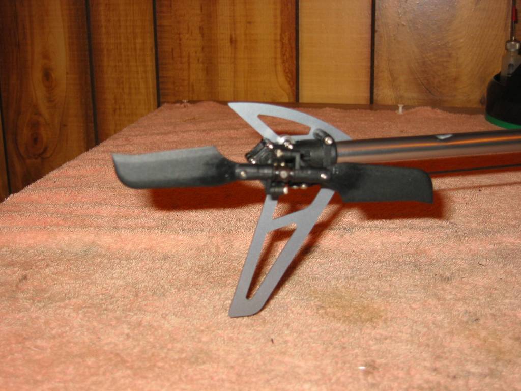

Pictures are worth a zillion words. The tail blade on the left, the trailing edge should point skyward. Put you finger in the notch and turn int counter clockwise. The main blades should spin clockwise, viewing the heli from the top. If that's all good, you may try to increase the setting in the TX for the gyro, by 2 percent, try it out. Continue to bump the setting 2 percent, until the spinnig goes away.
Also, you may have the tail servo move on ya. Check the tail sevo for centering. Disconnect the gyro and plug the servo into channel 4 of the RX, make sure the sevo is centering properly and that the tail slider is centered on the tail shaft. Disconnect servo from RX and re-install the gyro leads. (Channel 5 is for the signal lead from the gyro, it's the plug with one wire.)

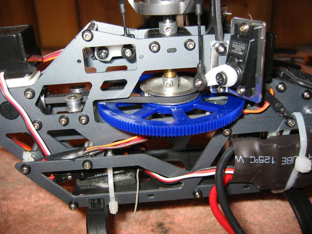

You rascal you, great eye there. It's a ding, but not bent. Had a tiny mishap. LMAO! Busted a brand new set of blades. Lol! Other than that no damage. I got a couple sets of 315 mm blades from Deal Extreme just to test them out. They are like $3.69 a set. Yikes, they are really pretty darn good. Free shipping, the down side is ya gotta wait for 3 weeks to get them. But for that price, I'm not complaining at all.

Do you push the rudder stick right to make the nose go right or do you push the rudder stick right to make the tail go right? The saying is" flying the tail or the nose". I'm not really sure if it will make a difference or not but might help to know
Just trying to help out and most know that I'm not a problem solver here[

Glad ya found the problem. Like I always say, "Set-up".. Takes some time to do it right and your in the right direction. A tweek here and a tweek there. Hey, you're getting some great flight times with the 1800 & 2200 mAh batteries.
