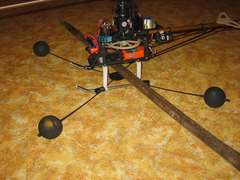

Jay,
I KNEW you'd love it, I'm not rubbing this in either (Oh, yes I am
) Couple things I noticed in the pictures, picture 1, looks like two of the three connectors for the motor to ESC are not plugged in all the way. Picture 2, check your main gear for worn teeth, hard to tell in a picture. Oh, speaking of main gear, I've got a Micro-Heli main gear. Perfectly round, made of harder stuff, much smoother than the stock main gear. Oh, forgot, it's pricey too, 39 bucks. However, it's lasted me much longer than 4 or 5 of the stock main gears, so it's kinda like an "Even-Steven" proposition. And it still looks like new. The stock main, will wear over time, and in a bad crash, usually will strip some teeth.
Pictures are great and I can tell you are having a good time with it. (Rub-Rub

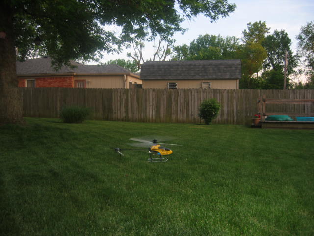

HEY, I found a couple old pictures of me, flying the Blade CP in the back yard. About 18 months ago. They are a little dark, but, (shhh), my wife took them, don't tell her.[sm=spinnyeyes.gif]

Dave, great eye on the pics. The connectors I'm using match up but don't push all the way in. I secure them with a tight wrap of 3m electrical tape when it's ready to fly. I've been working on the programing so I unplug 2 of the wires to make sure I don't have a sudden OOPS and it spools up. I have the MicroHeli w/ oneway bearing gear sitting on the bench but until I completely destroy the stock one it will wait. It has just minor damage from the first incident but still very flyable. I'm waiting on switching to the Telebee gyro just to work with the stock one and test it's limitations. I turned up the gain today and it seemed to be better than before, although just hovering and no FF. I'm also waiting to put the Carbons on. I'm finding that the stock woodies are very hard to tune. Low speeds tracking is off, midspeed/hovering they are right on, highpeed punchout they track off again. They are probably warped.
God Bless!
Jay

Jay,

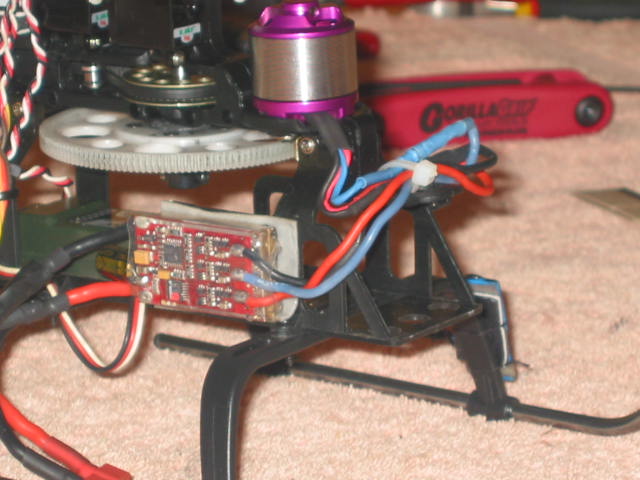

Good idea on the electrical tape, don't want anything to short out on you. When programming for the idle up mode, just use a crowbar for weight, see picture.
You need to anchor the motor and ESC wires, see picture for suggestions. You are a half a step ahead of me on the MicroHeli gear. LOL. See picture of mine, had it for 4 or 5 months now and the teeth are like new. Need to get the oil off them from over oiling the bearings. Yuk-yuk. I too, am running a Telebee gyro and it is wonderful, you'll like it, for sure.
And in closing, the stock woodies are okay/alright for puttering around. But when you want to get somewhat serious and go for the Budlight, you need the Carbon Fibers. [sm=punching.gif]
Have a ball with the HBK2, I do,

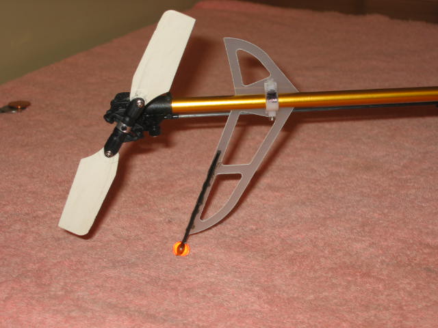

Here's a pic of my tail saver mod, " Tip of the day" from Dave and well reproduced by Rick. I had at least 4 tail "rubs" making routine landings and this mod works perfectly, no tail touches sense. Thanks Dave[8D]

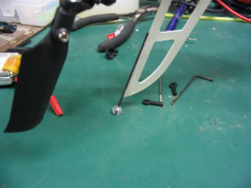

Jay,
Your welcome for the vertical fin mod. And thanks for posting it. What amazes me, is that I receive alot of PM's from others thanking me for my "Tip of the day" posts. Yikes! I need to dream up more. The old computer brain never shuts off.
I maybe wrong, but I don't remember a picture you posted with the "Tip of the day" modification on the vertical stabilizer.
I may have been taking a nap. Yuk-Yuk!

Jay,
I think this is my original picture of the vertical fin mod. You did a nicer job.
Dave / Choppersrule
