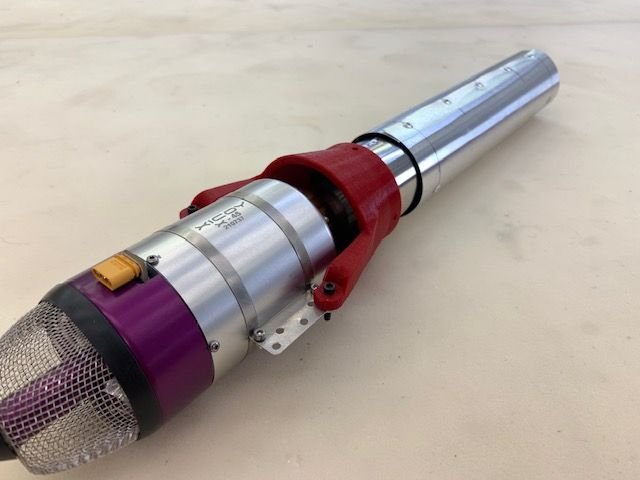

Pipe bell mouth
The plan is to use one of Keith's 3D printed pipe bell mounts from high temp heat treated PLA. Keith has been using these pipe cones for a couple of years with great success. This cone is sized for the K-45 and is designed to use the rear holes of the turbine mount to index the proper spacing from turbine tail cone to the leading edge of the pipe. As the photo shows here the K-45 mounts are larger than the X45 so Keith sent me a new CAD file for the X-45.
New cone design for the X-45 on the screen for printing
Printing started with regular PLA since my high temp filament had not been ordered yet
Pipe cone for X-45 indexed to rear turbine mounts for a 20mm spacing from leading edge of pipe.
The design had to be adjusted slightly for the inside of the cone mounting arms to clear he turbine mounting clamp bolts.
Relief cuts to clear the turbine strap bolts

My Feedback: (20)
Fabricating Pipe
The plan is to use the same pipe as Keith has been making for a couple of years. It will be a dual wall pipe with inside diameter of 46mm and outer pipe of 52mm. The 3D printed cones are sized for 46mm diameter inner pipe
A damaged pipe I had in the shop was cut open to use the stainless steel for the inner pipe.
The size of the metal for the inner pipe is marked and cut. A 10mm overlap is planned for spot welding
Since I now had 3 test printed pipe cones I used them for sizing collars during spot wielding to hold the proper diameter.
A 1.5" diameter table leg from Lowe's is used for a work mandrel and clamped to the work table. The pipe and collars are slid over the mandrel. The battery powered foot pedal controlled spot welder from Amazon is on the table charged and ready.
First spot welds to tack the end in place
Spot welding complete and collars removed.
Test fit works good
Test fit works good

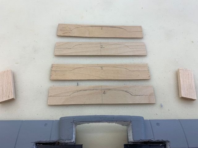

My Feedback: (20)
Installing turbine mounts
I used my laser level to project the thrust line down inside the area where the foam was removed
The laser when aligned with the marked lines allowed the thrust line to be accurately transferred to the fuse sides
1/8" plywood plates positioned 1/8" below thrust line and glued to foam with E6000 and allowed to dry
Setting the depth of cut for the turbine mount slots
Foam slot cutting technique is from Paul A's videos
Ready to melt foam slot
It took about 4 to 5 reheats to cut and smooth out the slot
Turbine mount test fits.
Slot cutting technique workd great
NIce and tight fit
I was pleased with results
NIce and tight fit

Preparing for carbon tow carry under spars
1/16" ply spar formers were fabricated
Spar formers marked and ready to cut
Dry fit of spar formers after cutting
Bottom view of spar formers with pipe channel cut out
Balsa separators dry fit to keep the formers square
Spar formers glued in with thickened epoxy
Epoxy cured
Pipe channel sanded smooth and high spots removed with sanding mandrel and 80 grit paper
Finished spar formers

Pipe mounting
Some final adjustments made with drum sander to allow pipe to be installed from turbine hatch with bell mounted
A small radius needed to allow pipe to slip in the tail
Four plywood pipe standoffs taped in place
Stand off positions marked on top and bottom
Standoff epoxied in place
Front ends beveled to allow pipe to slip in easier
Standoff cured ready for trimming
Standoff marked and trimmed with sanding drum
Bottom fiberglass part dry fit
Bottom fiberglass shell epoxied in place
Top fiberglass shell epoxied in place
Tape removed
The gap between the bottom foam parts was filled with thick epoxy and two layers of fiberglass cloth to give it strength
Primer applied
Foam filler applied and sanded. 3 more coats of primer applied and sanded. Primer applied to aft end of pipe.
Came out ok
Tape removed
Primer applied
Came out ok
