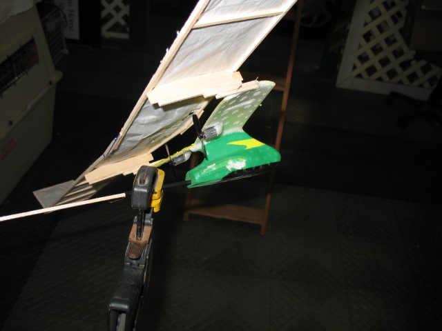

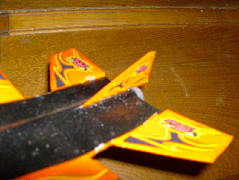

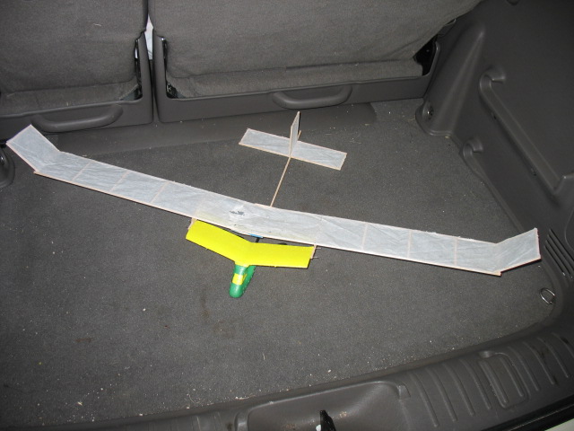

Here are pics of my latest aero mods. These are based on the mono mod. To remove the lower wings start at either the front or back and slowly peel the wing off. It is held in place by soft glue. With the lower wing removed you'll find that the plane is faster, but less responsive. It will float it flight. In these pics I have taken plastic stir straws and anchored the wing to the body more securely. This is a somewhat harder plane to fly. For the mod with only 2 stir sticks the length of the stir stick is 3.25". For the double stir stick the lengths are 3 3/8 and 3 7/16 approx. The goal is to maintain the original wing angle. These planes are far more responsive than the bipe or the plain mono mod.
ID:	543656   Click image for larger version

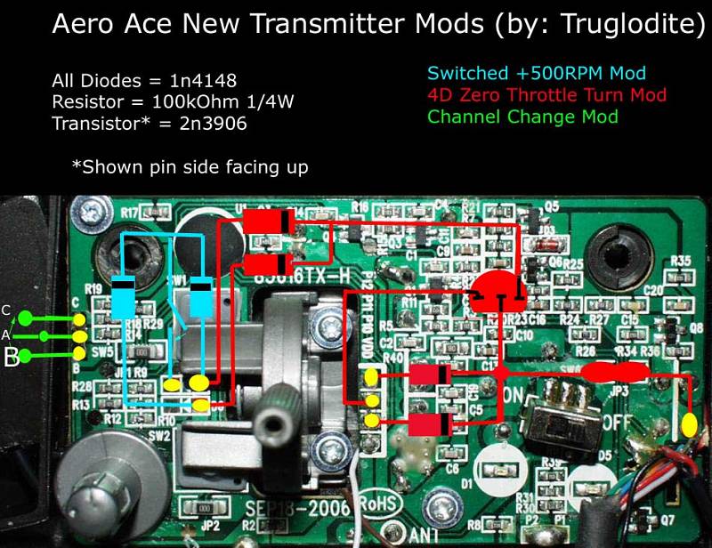

stats:
3 channels, A, B, C - 27mhz
130mah lipo

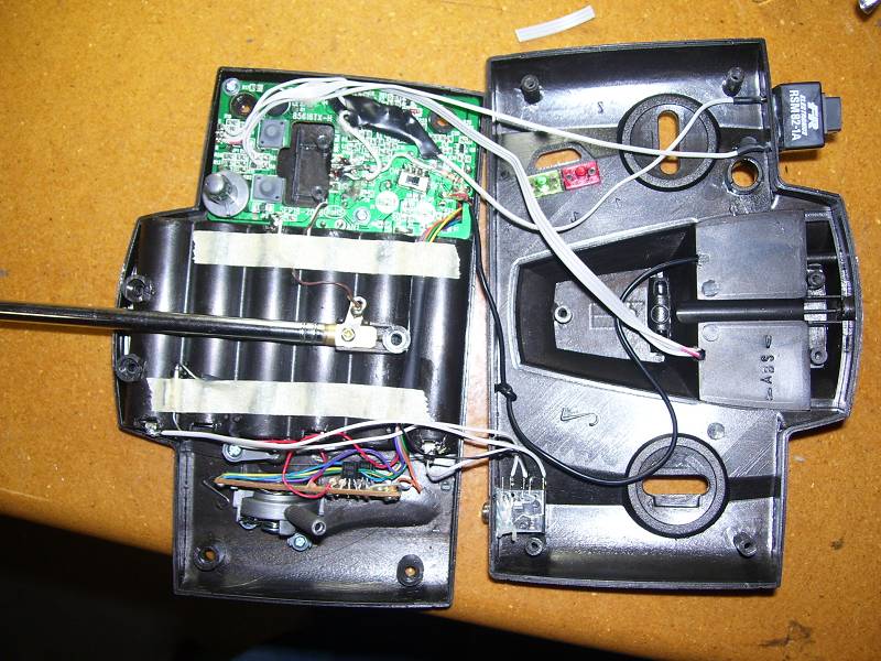

TX battery options:
2300mah Nimh rechargeables

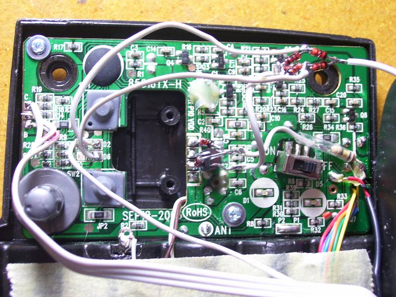

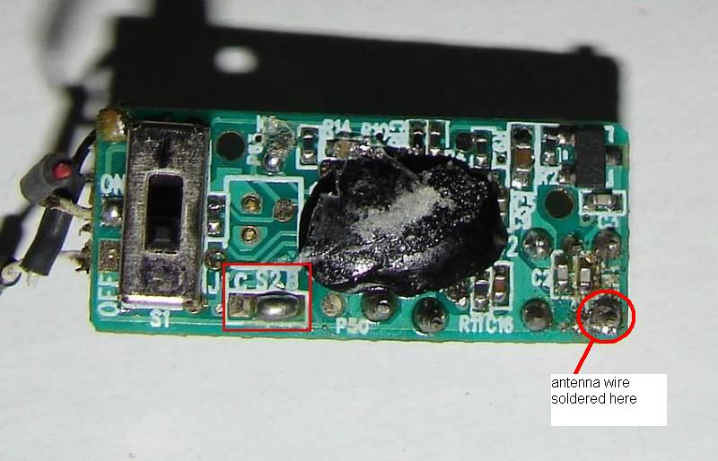

electronic mods
RX wiring diagram:
post #1451 http://www.rcuniverse.com/forum/m_33...59/key_/tm.htm
post #1603 http://www.rcuniverse.com/forum/m_33...65/key_/tm.htm
post #3192 http://www.rcuniverse.com/forum/m_33...28/key_/tm.htm
channel changing:
post #432 http://www.rcuniverse.com/forum/m_33...18/key_/tm.htm
post # 3558: http://www.rcuniverse.com/forum/m_33...43/key_/tm.htm
extending antenna:
post #450 http://www.rcuniverse.com/forum/m_33...18/key_/tm.htm
post # 520 http://www.rcuniverse.com/forum/m_33...21/key_/tm.htm

airframe mods:
wing extentions:
post #26,#35 http://www.rcuniverse.com/forum/m_33..._2/key_/tm.htm
post #419, #424 http://www.rcuniverse.com/forum/m_33...17/key_/tm.htm
post #1689 http://www.rcuniverse.com/forum/m_33...68/key_/tm.htm
post #2878, 2884 http://www.rcuniverse.com/forum/m_33...16/key_/tm.htm

My goal was to build a plane that would fly at walking speed. To accomplish, I built a 4" by 34" balsa and tissue wing and stabilizer. I don't have an accurate scale, but I estimate AUW to be 23 grams. The estimator says 4.6 MPH speed for stable flight.
The reality is that this thing needs a dead calm day in an open field to test. Fotunately, here in N. Calif we have spectactular weather this time of year; warm, clear and calm; sometimes all day long but definately at sunrise/sunset. As you may suspect, turning is an issue. The thrust differential is not enough to turn in much less than a 50 foot radius. I have not, but will do the transmitter diode mod, since I have plenty of transmitters.
I attemped something similar with heavier Bass wood frame (I didn't know the difference) and components removed from older AAs. I fried three RX's before settling on this approach.
Kevin L
ID:	551509   Click image for larger version

OK, I glued the canards in the straight with the fuse position. I also changed the channel from a to c. This plane has the same rx as the bipe. I'll know more about flight tomorrow. Tim
I forgot the pics. I think the change in the canard angle, combined with the down stab solve the wasout problem. Any way here are the pics. Tim
I increased the range by peeling the body apart an pulling about 1/2 inch of antenna out. I then used a bit of scotch gift tape to re-seal the fuse and cover the antenna wire. That increased my range to the same range as my aces, generally 300' up and 200' out.

Thanks for this great thread, everyone. It's just terrific to find all the mods in one place.
Here's my question. I have two AA bipes, both with a channel B Rx. I have three Tx's: two factory set to B and one to C. I'd like to be able to fly both AAs at the same time with my kids. The obvious solution is to switch one of the Rx's to channel C. But for the life of me I can't find instructions on how to change the Rx channel. I'm pretty clueless electronically, so maybe I'm just missing it. I see the instructions on how to change the Tx so that it can switch channels, but given my situation that's not going to help. I've looked at the pictures at http://www.rcuniverse.com/forum/m_33...18/key_/tm.htm, but, again, they seem to be all Tx pictures. I need to switch one Rx to channel C, not change the Tx to work on any channel.
I'm looking forward to firing up a soldering iron (mostly so my kids will laugh at how inept I am with it), but not sure where to start. Any advice -- or links to instructions that are probably out there but I'm just not seeing -- from this group would be much appreciated.

you're right, no links for the RX channel changing mod. odd, i wonder if i missed it...
well, anyway, this might help. i took a picture of the AAs RX, the red box is surrounding the 3 solder pads that you would use to change the channel. in the picture, you can see the three pads labeled C S2 B, and S2 and B are soldered together, and this makes it a B channel. if you want to change it to C channel, you just need to unsolder the bridge between S2 and B, then solder S2 and C together. if you want it an A channel, you can just leave all three pads unsoldered. its not too bad, since the pads are right on the edge of the RX. i also added an mspaint drawing to show how the pads would look for each channel, just to make sure things are clear

looks like adding some of these diagrams would've been helpfull to start off with. next time i update the page-o-links, i'll add them.
for now though, here's a pic showing where the antenna is soldered to. this usually requires removing the RX from the grey plastic base, there's two little screws holding the RX to the plastic. if you've got a fine tip on your soldering iron, you might be able to solder the wire back on without having to remove the RX from the plastic.
if the antenna wire broke in half in the tail boom, you'll want to make sure you either solder the antenna back together, or put a new one on. otherwise the range will be decreased.
nick

FAF, link doesn't work?
i know i haven't posted my pics of the new tx mods yet. can't think of a better time than now. i still need to include the switchable +500 to be complete (i mistakenly typed "+500" in the pic where it should say "slow turn"). when that's done i'll work on a new tx guide and post it to aatoolbox unless someone else gets to it first.
ID:	636177   Click image for larger version
ID:	636178   Click image for larger version
ID:	636179   Click image for larger version
